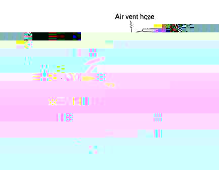

Re: Carburator Assembly
Hi JamesK
Dirk is on the right way
I have found another drawing.
The hose located on and between the top of the carbs is called "air control hose". It´s the yellow one in the drawing.
The hose you are looking for is called "air vent hose", painted red.
Best regards
Vaty
Best regards
Vaty
- Bild2.jpg (21.31 KiB) 17086 mal betrachtet
Guys, thanks a lot for the clarification. I'm never comfortable having unfiltered air coming into the engine or carbs so I was wondering does anyone see a problem with plugging this hose into the currently unused hole in the airbox as shown in blue in the updated diagram?
"Dirty bikes are like dirty girls......they are the most fun and have the best stories"
For my unstanding unfiltered air does not enter the carbs through the air vent hose.
The carbs are working like the venturi principle. So the carbs need an ambient air pressure to adjust the correct air and fuel flow.
When you plug the air vent hose, the carbs are adjusted with a static ambient air pressure. I don´t know what happens during, for example, different weather conditions with different ambient air pressure. It could be possible, that the carbs are not working correctly. Same happens during a drive from sea-level into the mountains. The actual ambient air pressure will change in this situation and the carbs are not working correctly.
So never plug this hose
Take care
Vaty
Take care
Vaty
